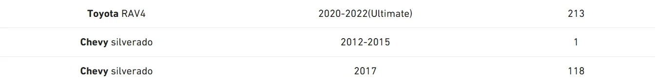

My dear friends, I know some of you have trouble in choosing our OEM bracket for your vehicle. This post is to inform you a little of it.

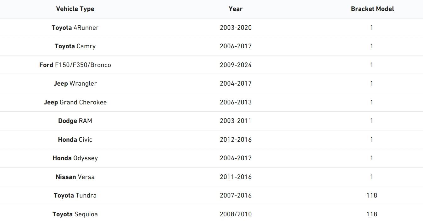

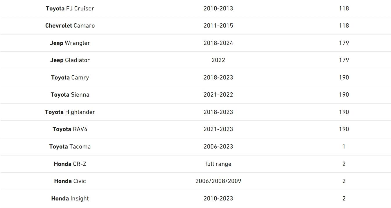

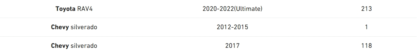

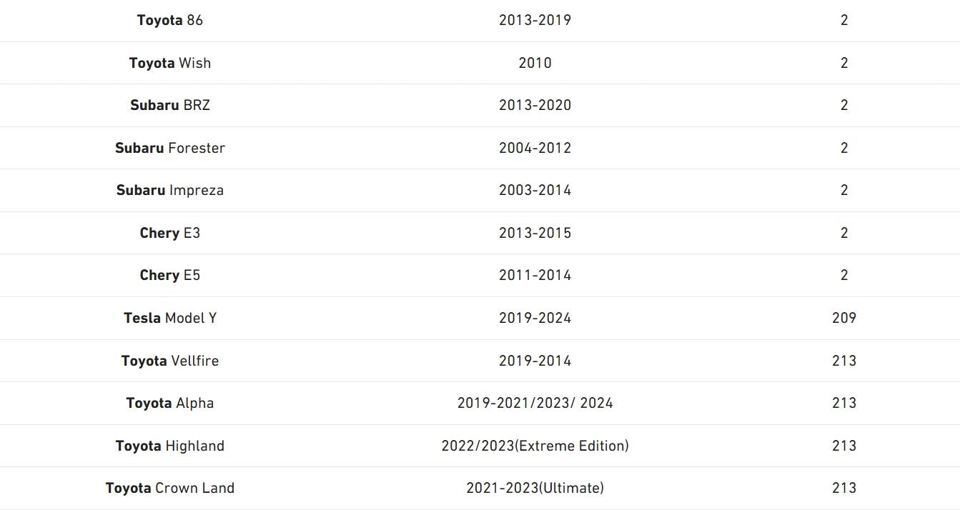

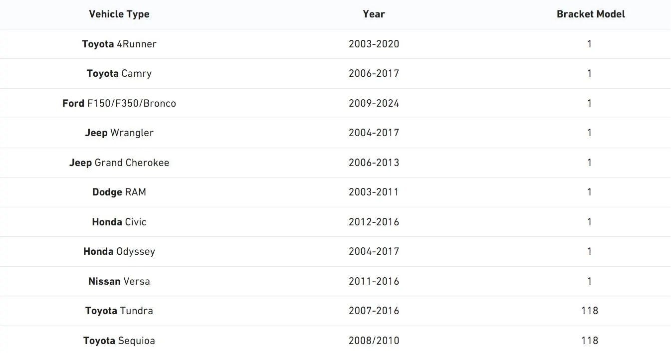

On Wolfbox website, the OEM bracket is listed in Dash Cam -->Dash Cam Accessories -->choose your model -->find OEM bracket. There you can see a compatibility table which helps you choose the right bracket model. The table is also listed below:

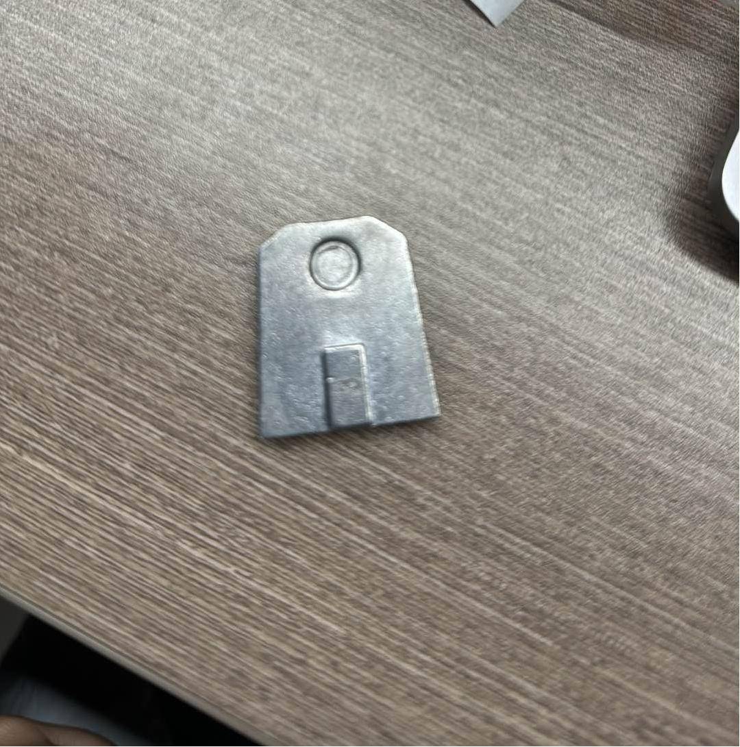

  1. Choose #1 bracket, and leave a note "need a metal piece" when check out.
  2. Remove the original bracket, including the plastic part and the metal part on the windshield.
  3. Use strong glue and paste the metal piece (flat side) to the windshield.
  4. Slide in the OEM bracket and drive the screw tightly.
